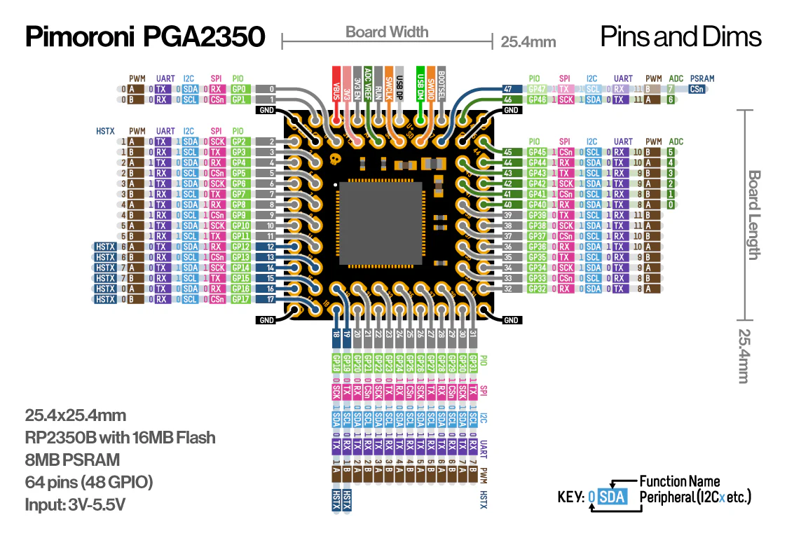

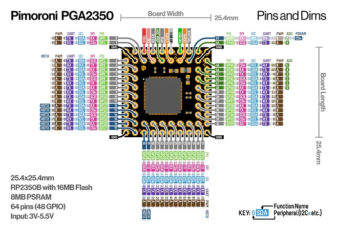

Pimoroni Pico LiPo 2 XL W is very close to the very minimal board I need, it just lacks 2 pins (more would be better).
- is there any option how to make any of non IO pins into them with this version?
- is there any plan to have a board that exposes all of the 48 IO pins of 2350b?
Thank you.
