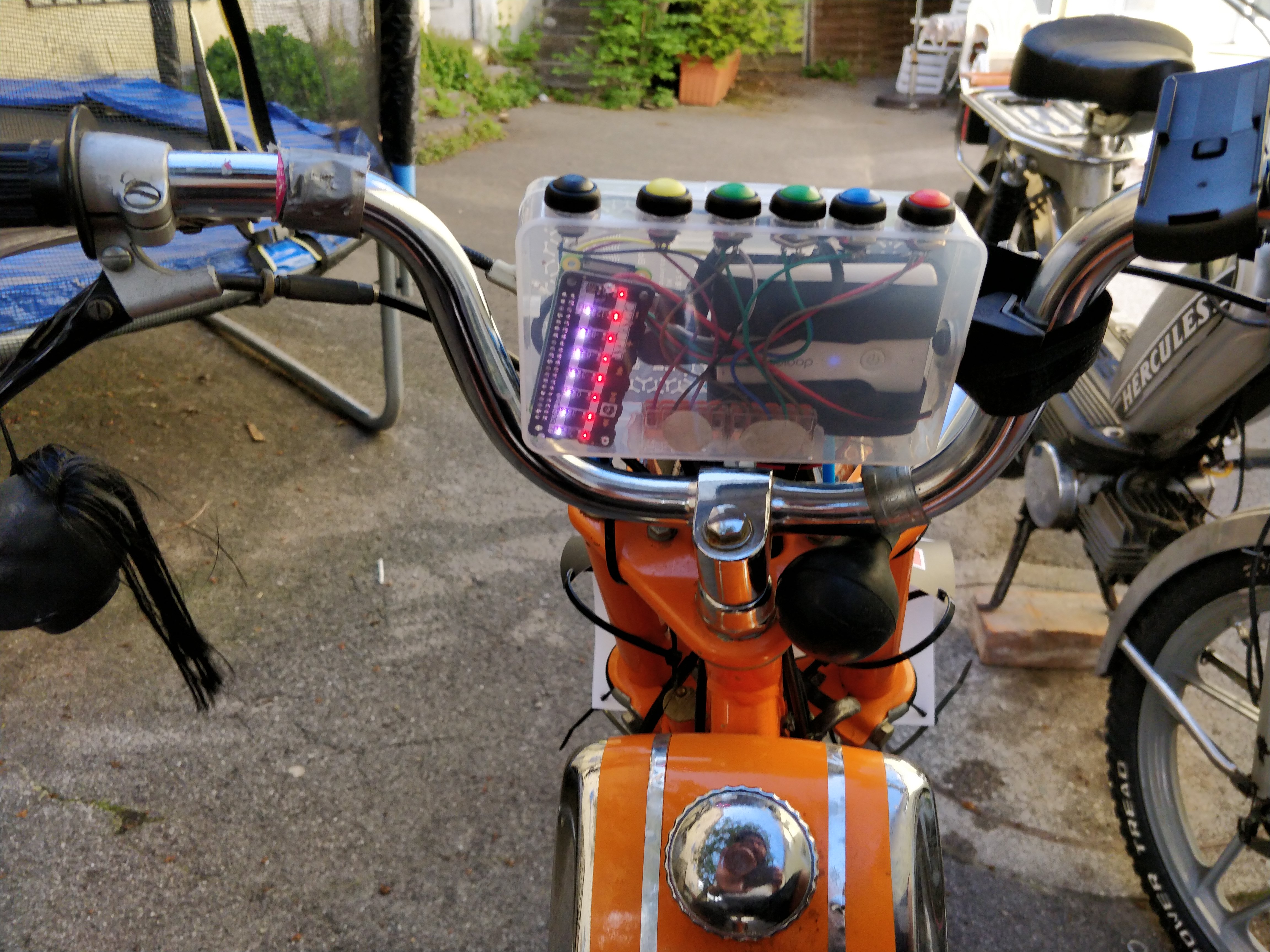

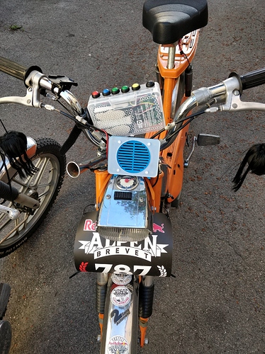

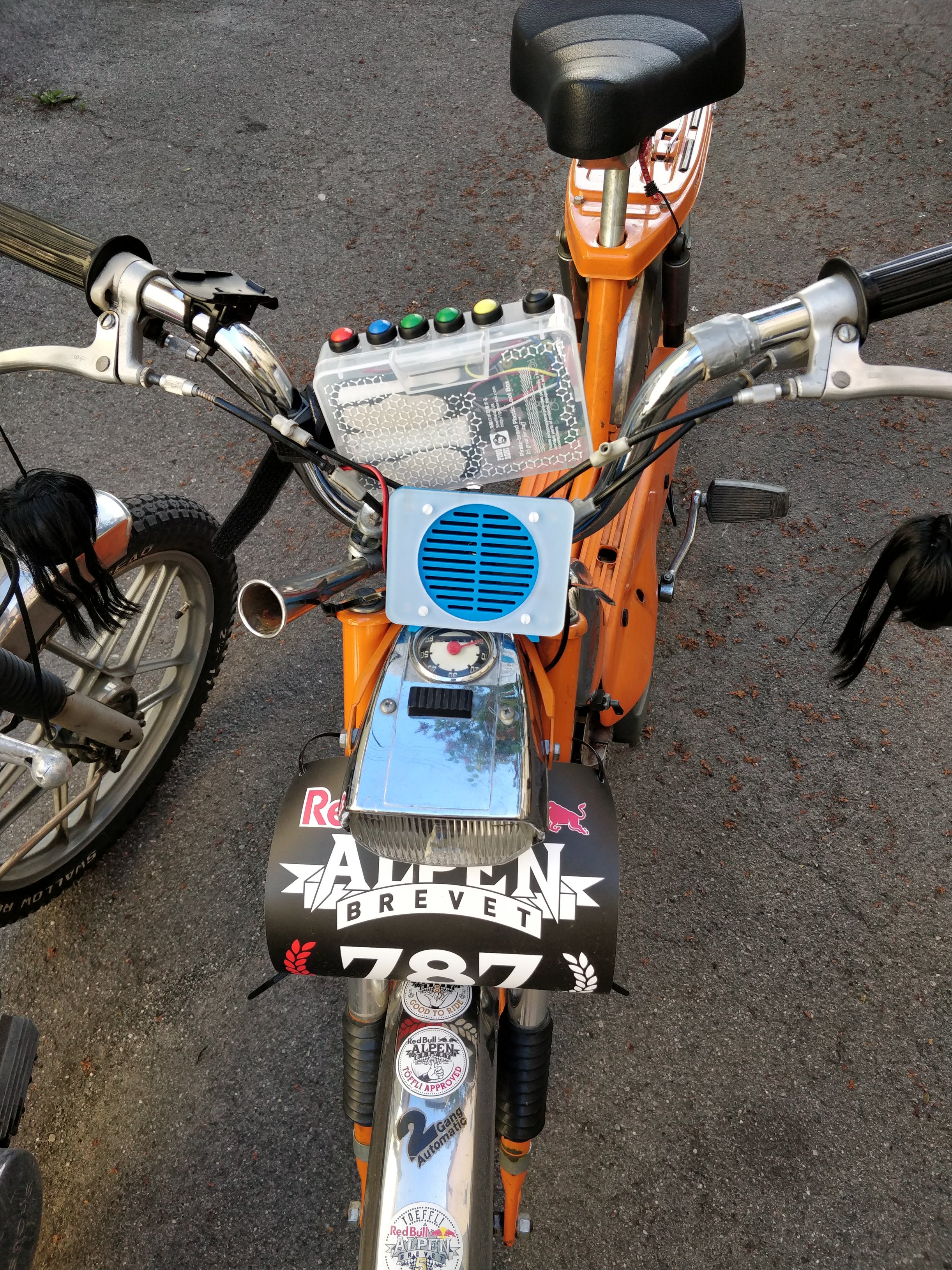

I ordered a bluetooth speaker which is hopefully loud enough (2x10w) and will leave the 5w speaker connected to the phat beat as default output, and mapped a script to one of the buttons of the phat beat which initiates bluetooth pairing and changes the audio output to bluez. A
I have to see how stable the connection is and how tough the bluetooth streaming is on the battery life of the pi.
With this setup I dont have to buy more parts for this project, the bluetooth speaker can be used for other stuff (and is waterproof).
Thats how it looks like at the moment, a 5000mah battery is inside the loot box, I probably need a bigger one mounted somewhere else on the moped
