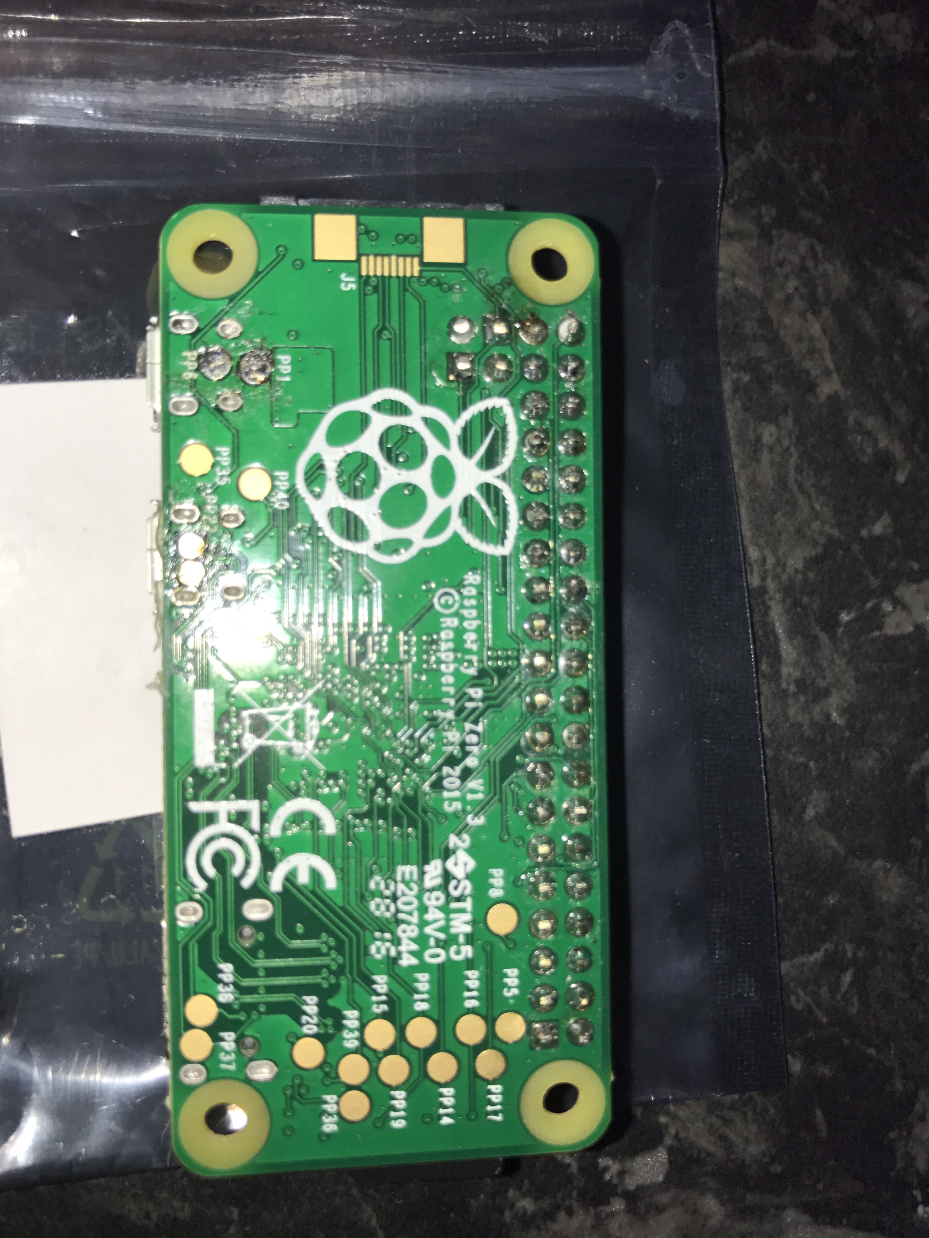

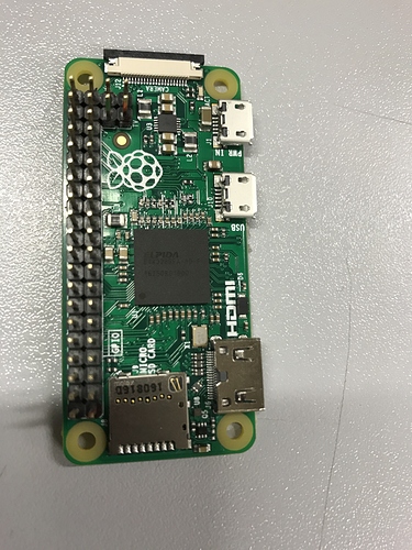

Out of interest, could you post a decent quality photo of the top of the board, please?
I see you fitted the optional 2x2 header… it’s a long shot, but verify that you don’t have any short there - one of those pair specifically is meant to ‘reset’ the Pi, so if that connection is continuous then you’d get something interesting happening (and by interesting I mean highly undesirable).
well, I guess any short along the 40-way header would also potentially lead to malfunction but I can’t tell from that pic whether you’ve got a clean soldering all along.
it’s hard to tell if the trace just below pin 40 could be damaged.
Regardless, pop support an email, but I do recommend you test the new one before soldering any header… like I said, the number of Zeros we’ve had DOA can be counted on one hand, so it’s unusual to say the least.
