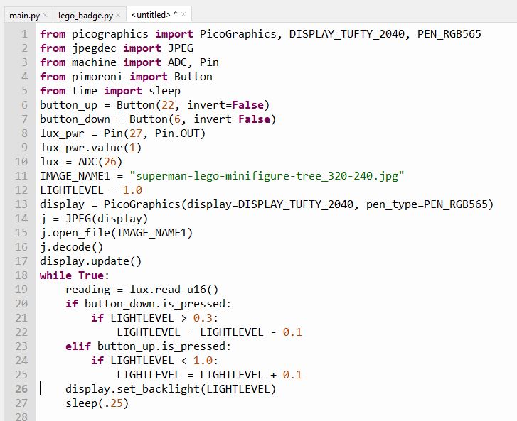

Then I wrote a quick program to display a photo, same basic items. Pen_Type = 565, no progressive jpeg. It works, no issues; displays correctly in all its 565 colour photo glory.
Now when I “call” that same photo program from main.py, it somehow reverts to 332. But if you run it, straight out (in Thony) it is works nicely.
Has the new firmware changed how it ‘passes’ the pen_type? (which really it shouldn’t – as both main.py and the photo program are 565.
(( I removed all of the extra blank lines so you can see the entire photo program )) –
(( Updated w/ testing using 1.19.12 code ))

I know I can rename my (photo) program → main.py and it runs just fine in 565.
