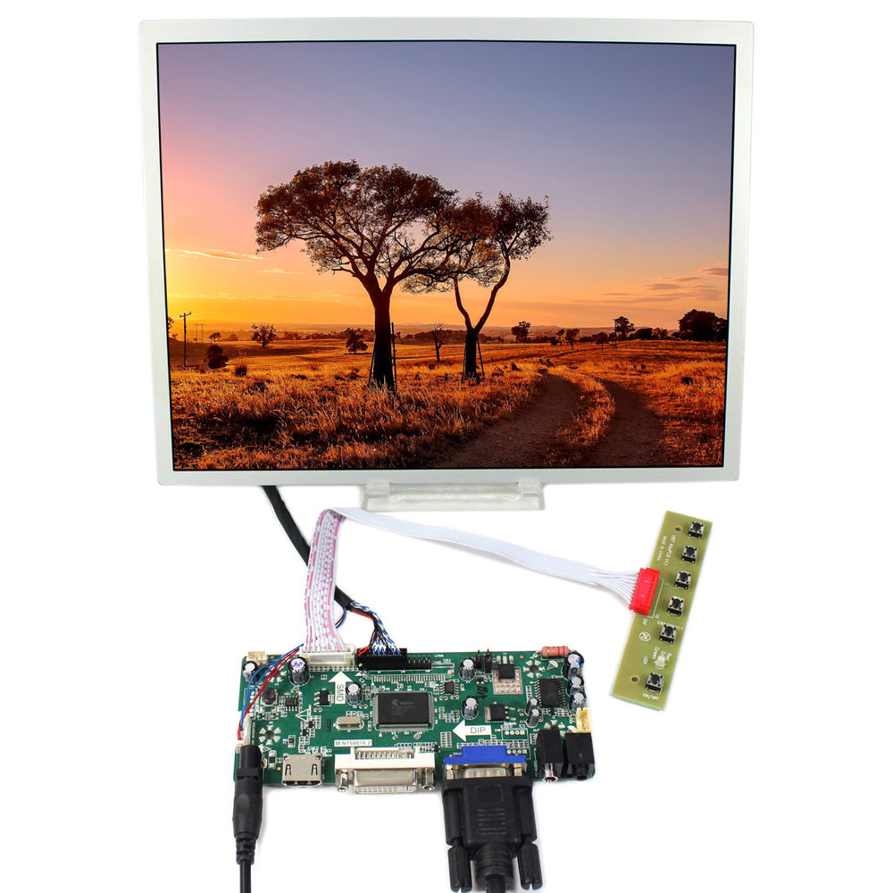

Well I went ahead and bought the SHARP mentioned off ebay…
will see how it works when it gets here in a few weeks.
FYI, the Sharp display (LQ121S1L75) I purchased on Ebay has a terrible viewing angle… If I could flip it upside down, it may be usuable, but as it stands, you can’t adjust it to make it worth using.

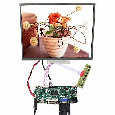

I bough this screen:
and this board:
And I am powering the screen with a 12V 4AMP supply. My screen is VERY dim. Please help?

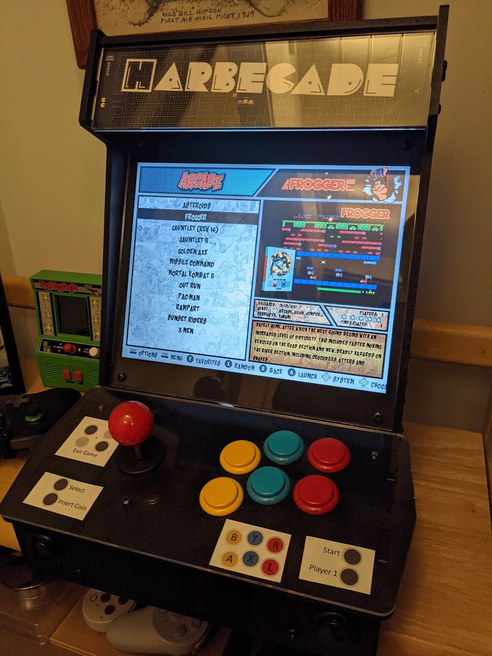

Did you install this in the first Picade? I have the original edition and I would like to upgrade the screen. I have been looking at the 10inch display from Pimoroni but this one is the same price. Do you have any pics of it installed in your Picade? Did you have any trouble installing it?
Yep, I had the first gen as well. I’d definitely go with the 12 inch over the 10. I just took a snapshot but don’t judge my lack of photo staging. :) I was mostly trying to get an angle you could see the screen and not the ceiling.
My 2 big tips. One is to make sure you test the screen out at the angle you will use it. I had to completely rebuild mine because I tested and assembled it at a table, where looking straight at it, then when I put it back in it’s spot, I’m looking down at an angle at it. I ended up reassembling it all with the screen upside down which messed up the wiring and I’d done so nicely the first time. Second, cutting down the cardboard bezel makes a lot of little cardboard flakes that come off underneath the plexi for weeks. I’m sure there is a way around it, but I ended up taking it all apart, yet again, to clean them out.
The screen looks awesome! Thanks for the tips!!
