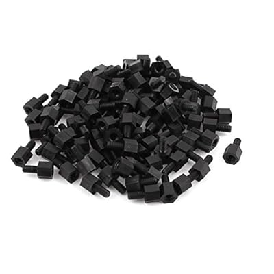

A little overkill for just this one thing, but this is what I did…
https://www.amazon.com/gp/product/B014J1ZLD6
It worked well while I had the Pi on the back door, but I’ve since moved it to the base because I hated how the HDMI cable would tork on the monitor connector. I think it’s much better on the floor and I’m still using the spacers to allow access to the SD card and adds ventilation below the Pi. WIN/WIN.
