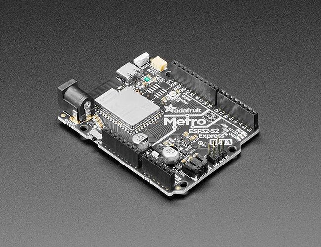

Hi, I have a problem with my new Adafruit Metro ESP32-S2: it does not show up as a drive.
I followed the Adafruit tutorial exactly on how to set the board up with CircuitPython. I flashed the latest CircuitPython to the board which tells me, that the cable is ok. Then I press “Reset”, the serial port disappears and then… nothing. The drive does not show up.
I tried it on 2 Macs, a Windows 7 and a Win10 machine with two different USB-C cables. I searched the forums (Pimoroni and Adafruit) but all troubleshooting requires that there is either the CIRCUITPY or the boardnameBOOT drive to show up. But neither does
Everything is the latest version, I’m outta ideas. I am fairly confident with all kinds of microcontrollers, but I can’t get this CircuitPython board running. It is my first and only CircuitPython board, so I can’t check another. Any advice would be greatly appreciated.
