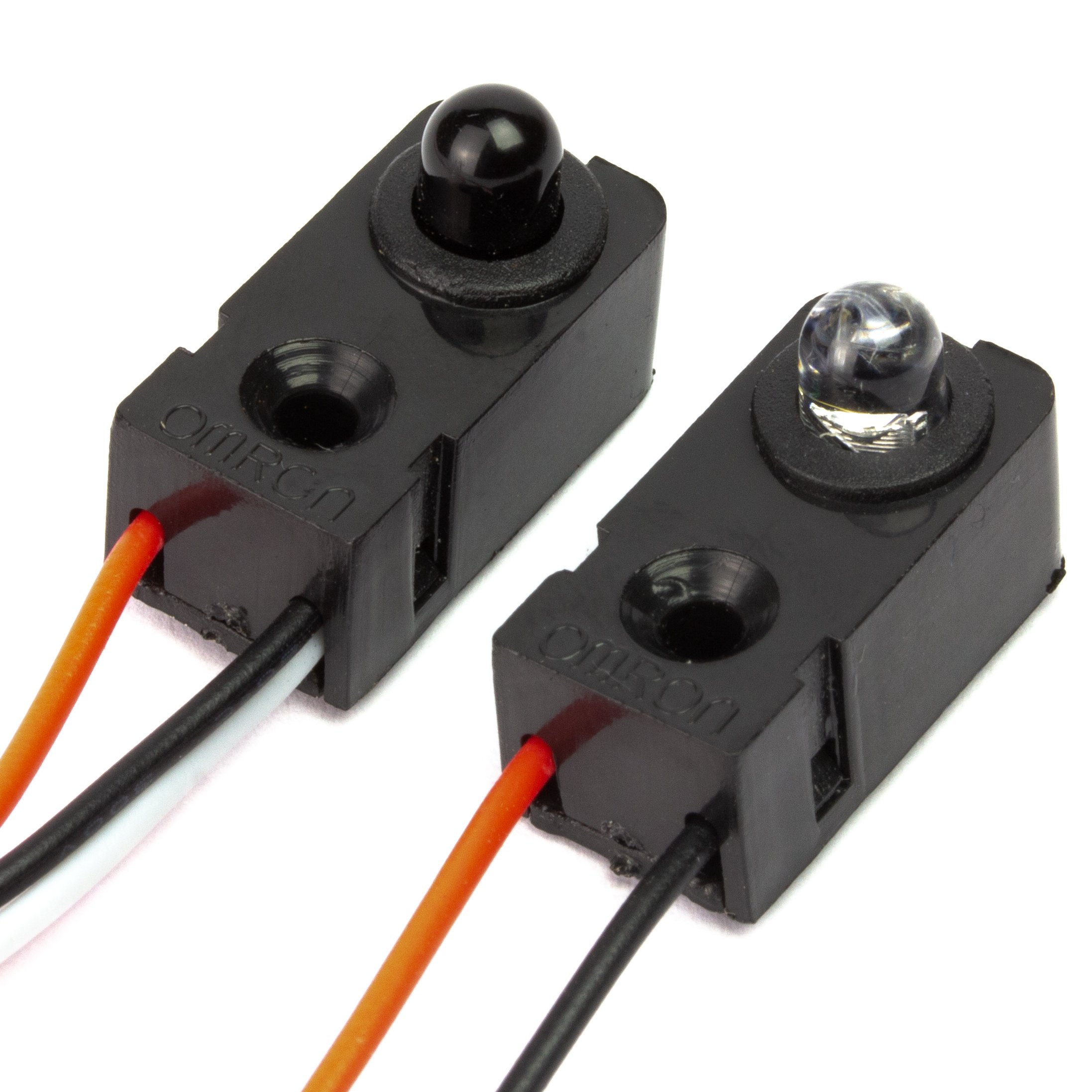

For detecting the ball going by this may work.
