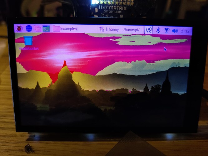

My hyperpixel touch 4 was working great but has all of a sudden developed a pinky tinge to the display. This is a fresh legacy buster OS install on a pi zero 2 W.
I have reseated the display cables to no avail.
Anyone have any other ideas?
Thanks
So it appears to be the pi that is the problem. I swapped the hyperpixel onto an old pi2 I have along with the SD card and it works without issue.
So now my question changes to what could be causing this issue on the pi?
Sorted it, it was a result of my poor solder skills a couple of the headers solder joints had come off/gone loose. A quick resolder and all is good.

Best guess is you lost a color.
