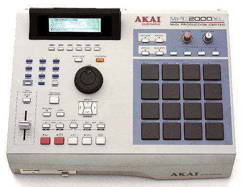

Background: Years ago music was one of my main hobbies, and MPC’s from Akai (see image above) were a toy I liked.
Never got one because I spent my money on turntables which I liked most.
Why not create a kind of MPC with the Explorer HAT from Piromoni?. In this project, I use touch pads from 5 to 8 to select a drum kit, and pads 1 to 4 to play the sound. This way we can play 16 loops as with the original MPC, need to be fast though!. I was lazy to look for 16 different sounds, I tested with 8. You can put your own sounds. The code is as follows:
