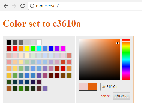

Had a pretty successful few hours on Friday afternoon and managed to hook up a jQuery widget I found to some Flask code:
moteserver
It would probably be sufficient to just have a Hue picker, but for now it works (albeit only one channel)! Next step is to tidy the Flask side up and get the other channels working!
Ooo, a full colour picker UI! Nice.
You could probably set it up so that you can paint custom patterns/fades/swipes and all sorts of cool stuff on the fly :D
Can’t take any credit for that, just grabbed the first one I found online.

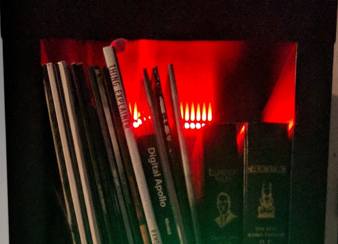

Here’re the installed Mote sticks:

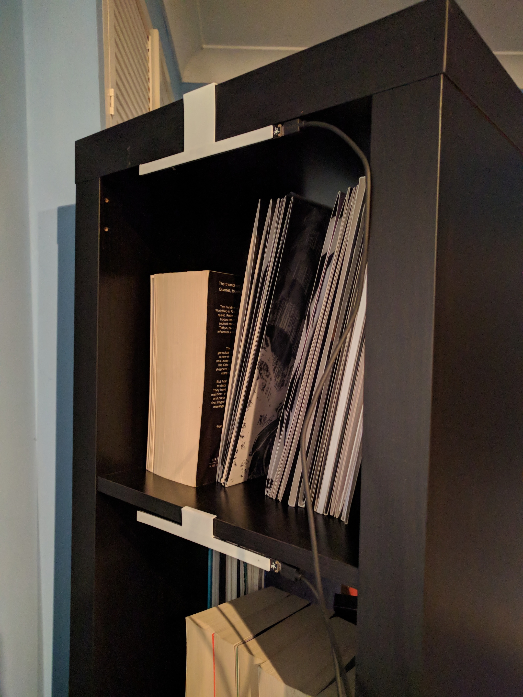

And some photos of the installation (I’ve since tidied the cables and applied liberal amounts of double-sided tape):

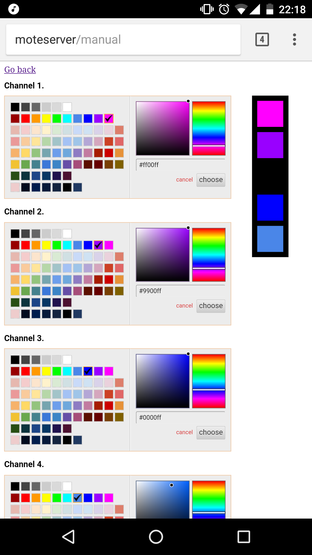

Here’s how the UI currently looks:
