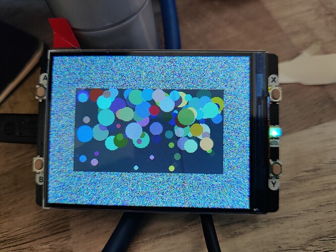

Hi,
I just got the pico display 2.8 and I have been running some of the demo scripts in micropython using the firmware from GitHub - pimoroni/pimoroni-pico-rp2350: MicroPython builds for Pimoroni Pico 2 / RP2350 boards. Every demo seems to end up with this uninitialized border around roughly half of the screen. After a little bit of testing it seems like resetting the screen to some solid color and then running the demo script again will result in that fill color around the border instead of the noisy pixels in this example.
What might be causing this border behavior and why is it happening out of the box like this?
If you have a Display Pack 2.0" or 2.8" use DISPLAY_PICO_DISPLAY_2 instead of DISPLAY_PICO_DISPLAY
Did you do the above?

OMG, it was literally the first line of the script. Thank you.
It’s an easy mistake to make, easy fix though. ;)
