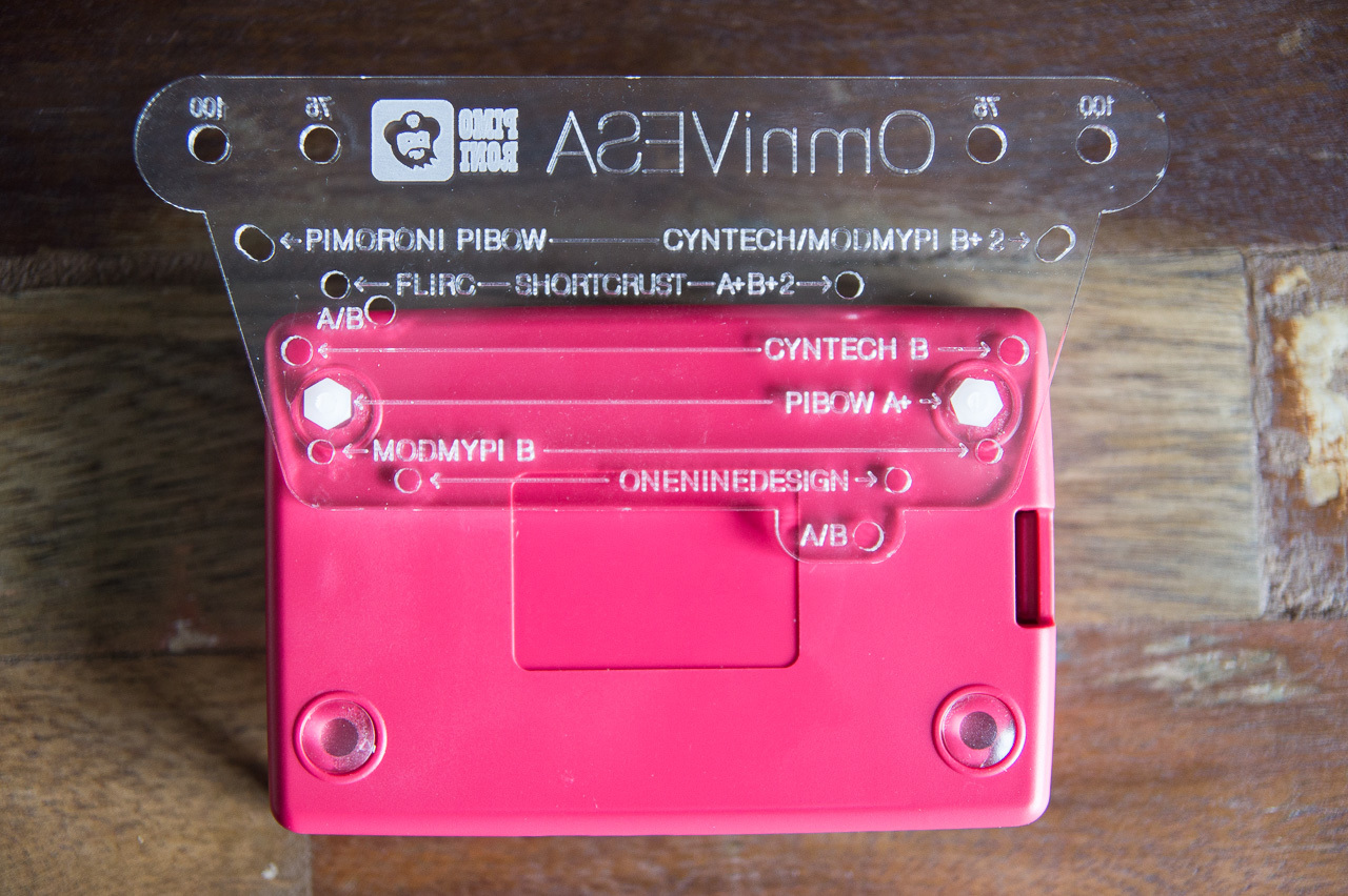

I can confirm it works really well with the official case, but does require DRILLING!!
The best way I found was to remove the top set of sticky feet, and then drill through with a 3mm drill bit. The resulting holes should be exactly the same width apart as the holes marked Pibow A+ on OmniVESA.
Then, it’s just a matter of using the two bolts and nuts that come with OmniVESA to attach it the case.
Hopefully the photos below should be self-explanatory. Let us know if you need more help. :-)
