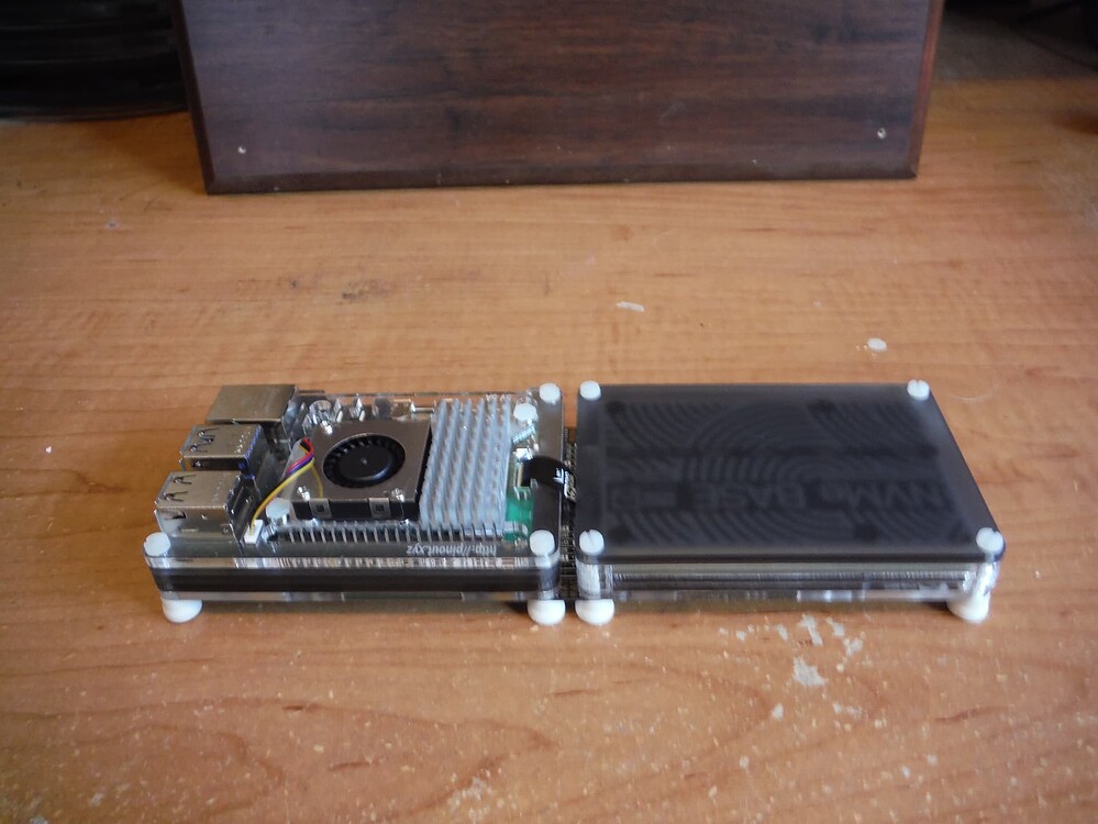

@alphanumeric: could you re-post your image of your setup? Something like that should also work here.
My original setup was a side by side.
I have redone it for an over and under.
I don’t see any extra cooling in the pics, do you just cool passively?
Yes I just cool passively. It’s not a DUO, it’s just the Pimoroni NVMe Base.
