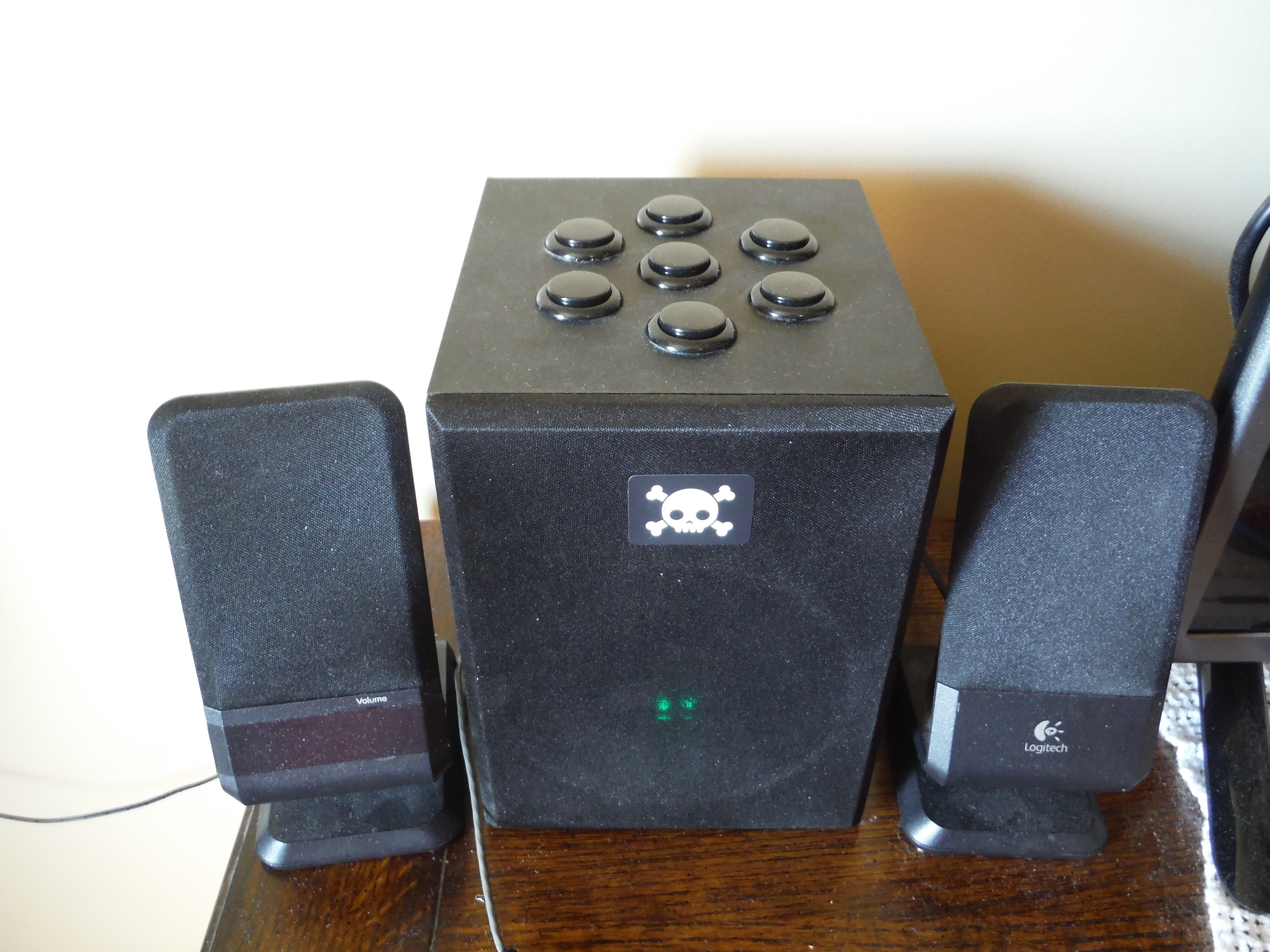

So I have built the Pirate Radio kit successfully.
I am looking to put it in an enclosed case. However this would likely hide the buttons on the pHAT BEAT from being accessible. To fix this I was thinking of using a button membrane, such as the one here, 1 2 3 4 Key Button Membrane Switch Matrix Array Keyboard Keypad Control Panel Pad DIY Kit For Arduino 2018 New|Integrated Circuits| - AliExpress. Although I would be open to suggestions of suitable products that Pimoroni sell.
My question is about how best to connect the button membrane to the pHAT BEAT and Rpi Zero.
I was wondering if the suggestion in the comments here, Ikea Dragan Speaker Box by drgrandios - Thingiverse, and using a Rpi Zero WH with a 2x 20 Female Header would work? If so, could someone explain how I link the 3 components together?
