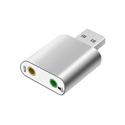

This is the one I bought :
It’s usb so just plugs in, but beware it’s wide and blocks two usb ports, so you probably want to use it in a USB hub connected to the rpi (doesn’t need to be a powered hub, worked fine without additional power).
And I followed these instructions to set it up:
http://sudomod.com/forum/viewtopic.php?t=144
It works very well, apart from the fact I get no audio on my initial startup video, presumably because the USB device hasn’t been recognised until after it plays. After boot up is complete the sound works perfectly and sounds a lot better than the Rpi audio out.

I used the usb Soundcard. Followed the instructions to force the pi3 to give the Sound via usb. And… ERERYTHING works perfect. No crackling sound, no hiss. I am Happy.
