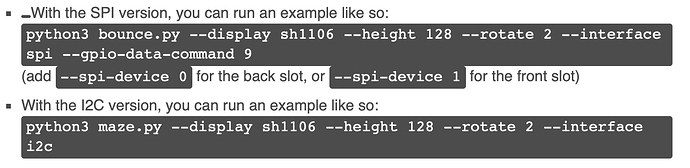

I don’t think there is any specific code for the BG except for designating the SPI slot. The I2C boards take care of themselves. The single SPI slot on the BG Mini is slot 1 instead of slot 0, which threw me off.
