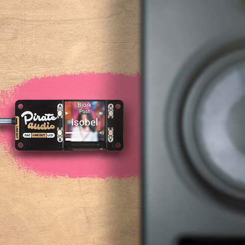

so i jumped on the whole pi-train very late and excitedly picked up two scroll pHats not realizing they required the pHat DAC which is now impossible to find.
Is there any way to get the project to work with a different DAC? the only 40 pin DAC I can find for the pi’s is this one:
But even then, the pins don’t go through to the other side so I don’t think it will work… but I hope I am wrong?
Or that there exists some solution for me to put these scroll pHats to good use.
Thank you in advance.
Does it need to be line out?
Would this help?
