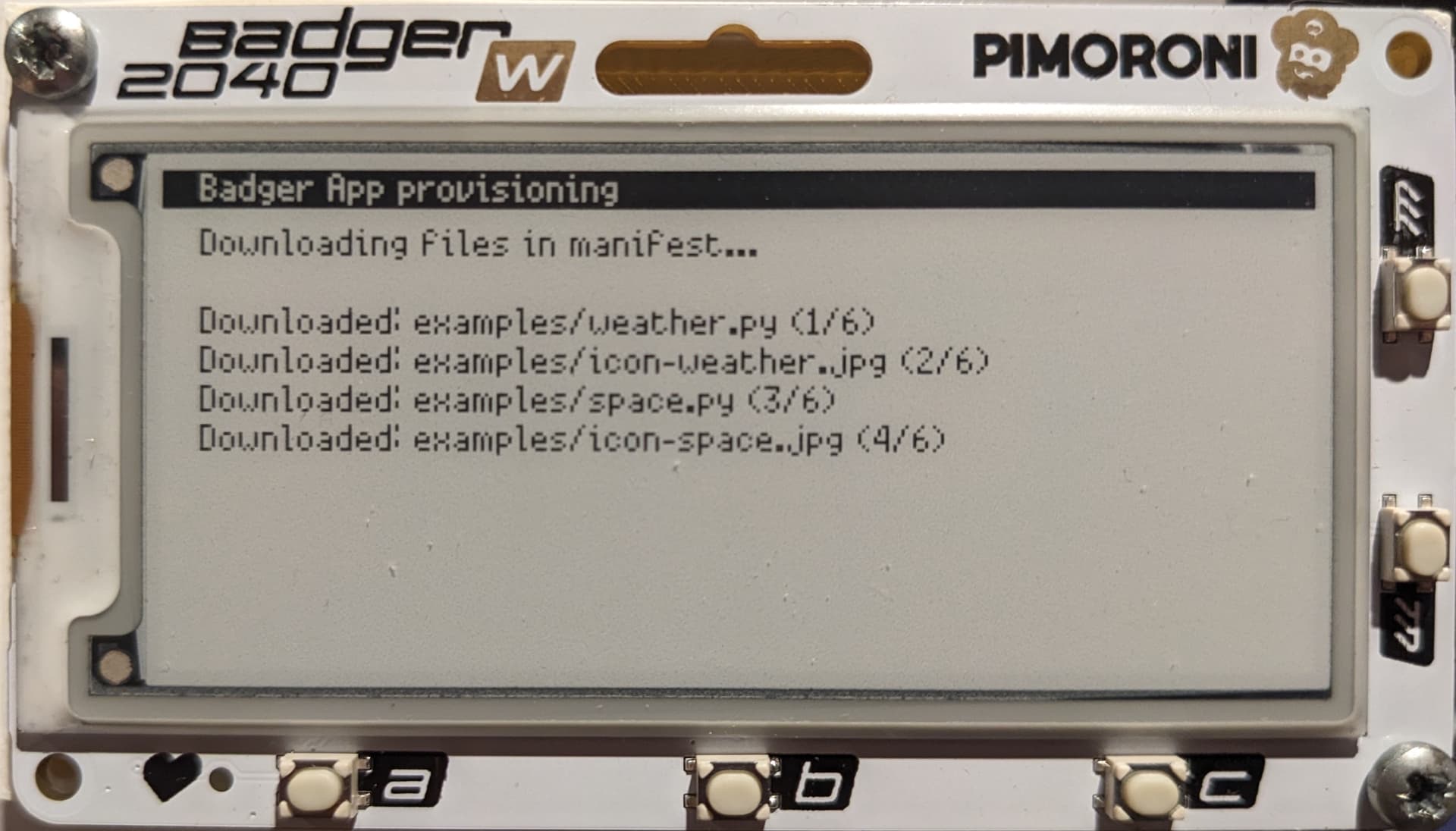

Using Thonny to copy your code and apps on to the badger2040W can be a bit of a pain. This functionality allows a user to provision a list of apps to the device remotely over a wifi connection. The main function here is that you can write an app and stick it in an ‘examples’ folder on a github repo or other source. The ‘apps’ app then consults a json file which maintains a list of the apps that you currently want on your badger2040W. It downloads the apps from your repo (it also removes apps not currently on the list), then restarts the launcher to update the badger’s homepage.

Don’t forget to add an icon for each app, or the system will freeze.
