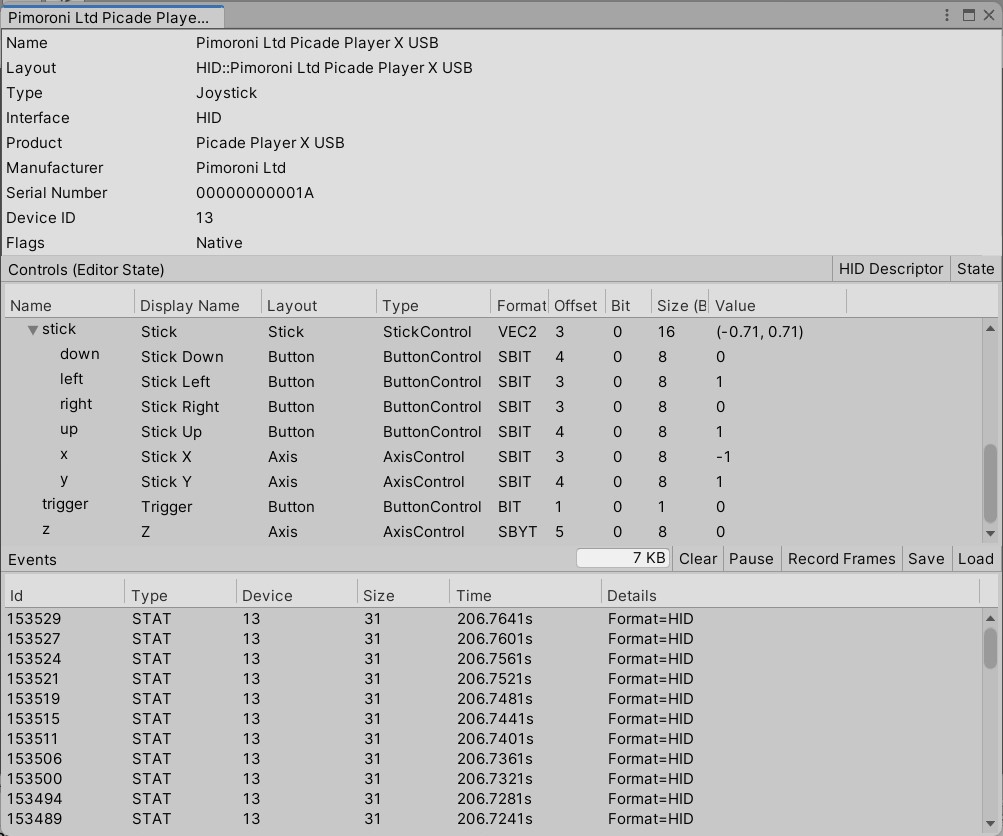

The joystick gives me odd input values which are not usable in Unity as follows: (I can only post 1 image as a new user)
Centered = Up & Left (-0.71, 0.71)
Left = Up (-0.01, 1.00)
Right = Up (0.01, 1.00)
Up = Left (-1.00, 0.01)
Down = Left (-1.00, -0.01)
