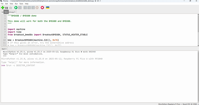

I have the Pico breakout garden base, a Pico W with picow-v1.25.0-pimoroni-micropython.uf2, and the BME688 breakout. When I run the example bme68x_demo.py in Thonny, all I get is a blinking cursor like this after hitting enter on the run line: Any suggestions? I can read the BME688 using a Pico Plus 2W with Adafruit Wipper with no issues. Perhaps the breakout garden is just trash. I’ve tried each of the I2C ports on it with the same results. I’ve verified power to the I2C ports (3.72V)
I ran an I2C scanner, and it found no I2C devices on any of the ports.
