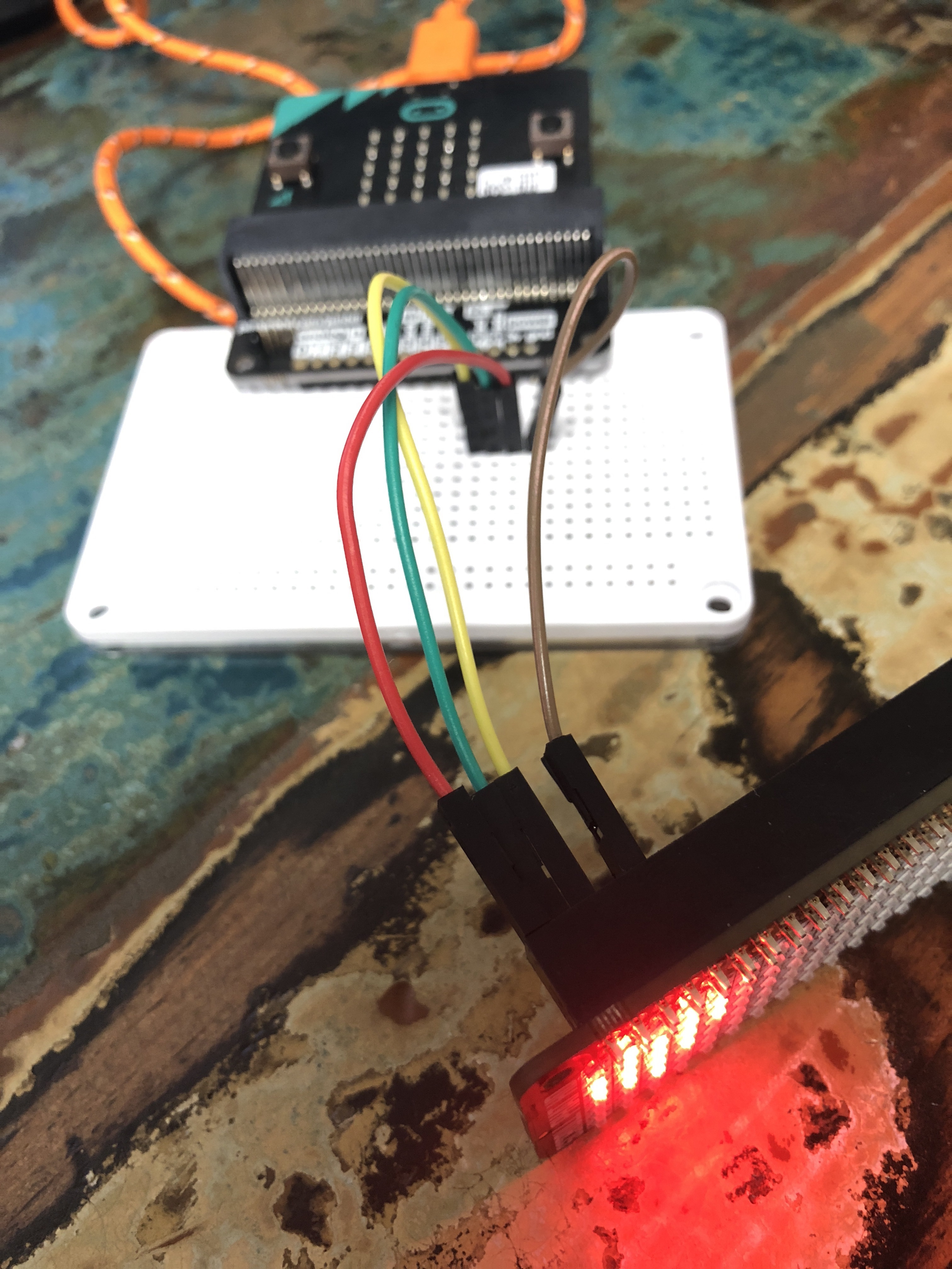

As long as you keep the brightness low, you can wire a Scroll pHAT HD right onto a micro:bit with pin:bit
