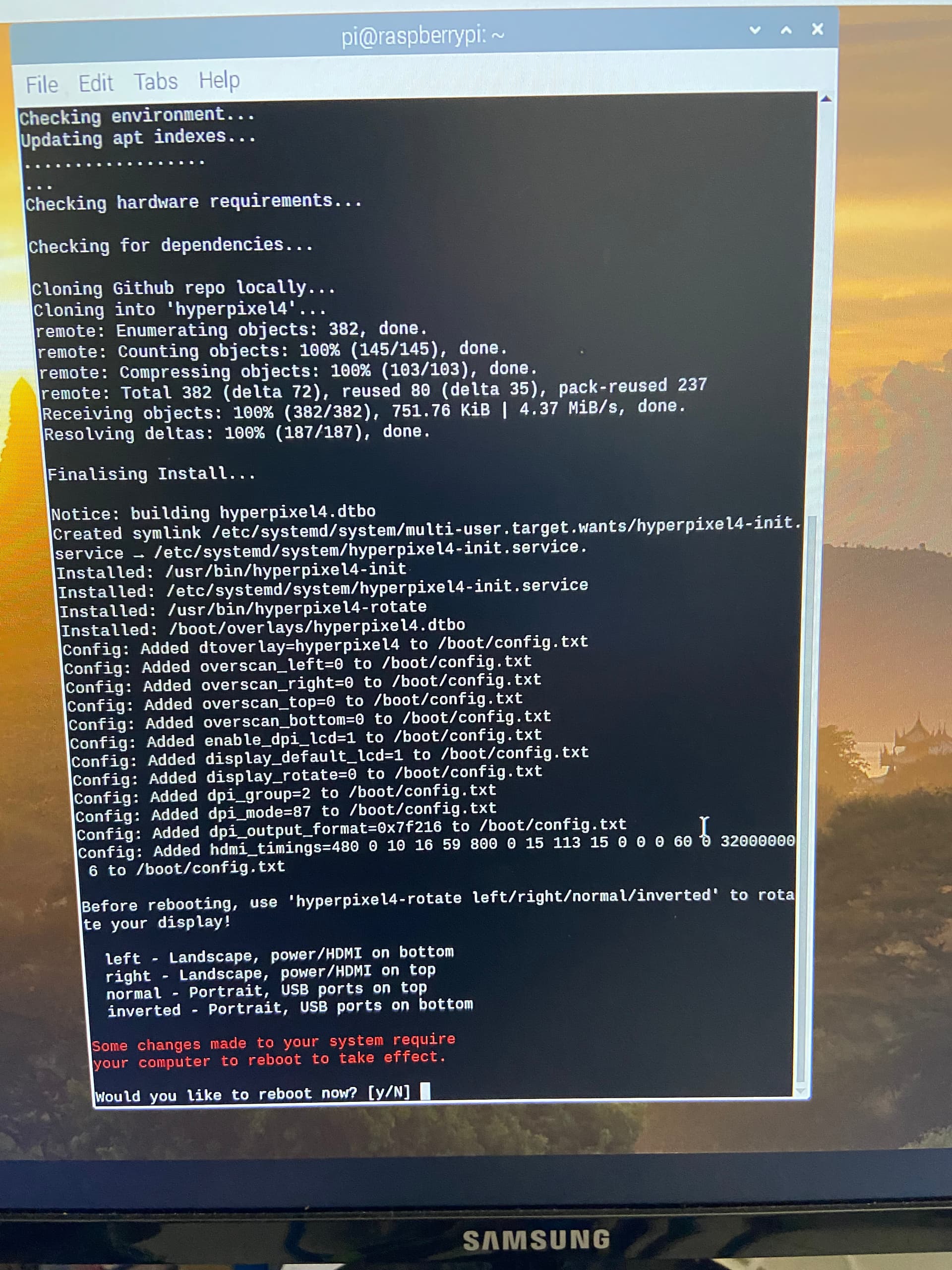

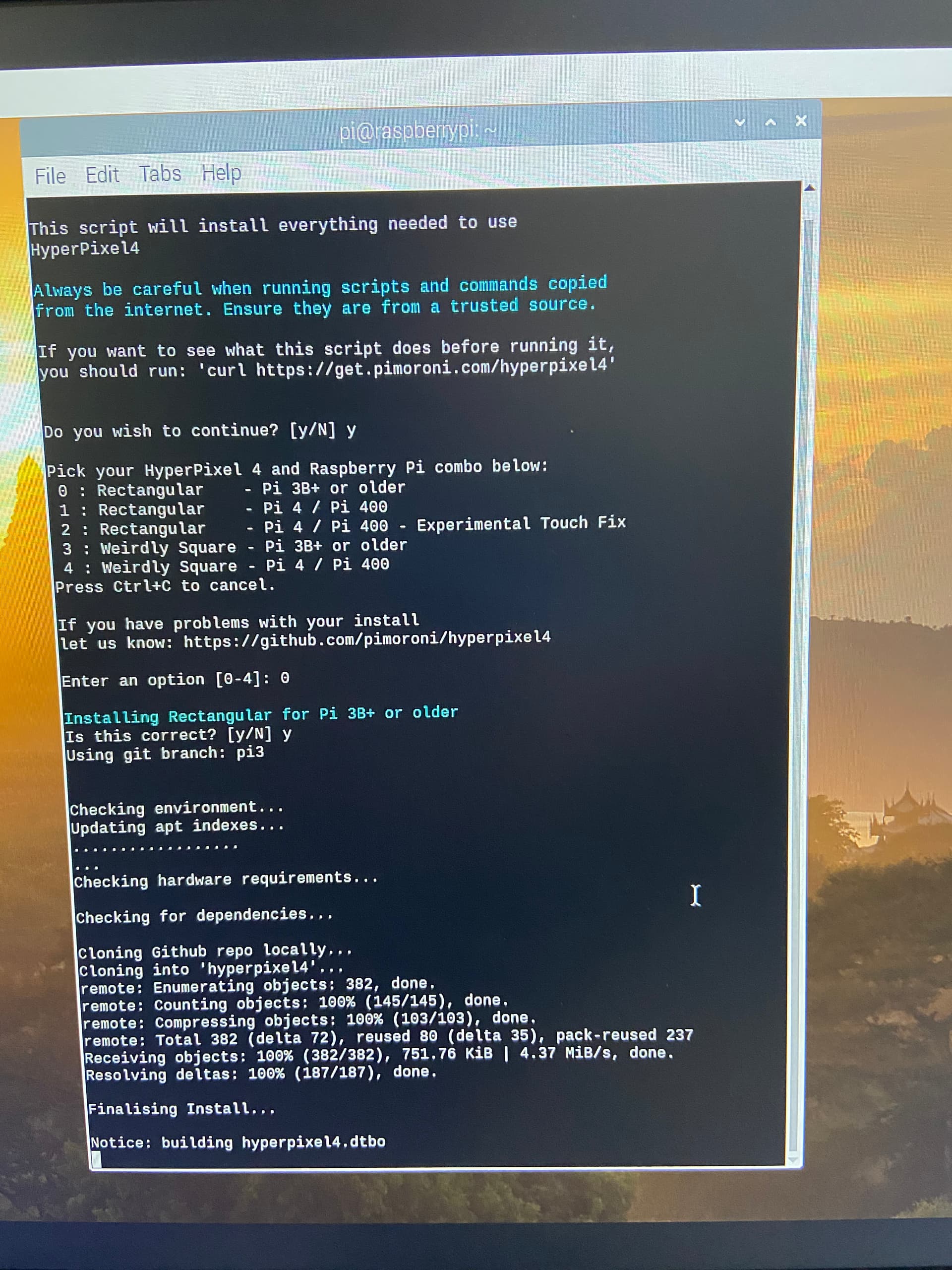

OK, is that using option 0 : Rectangular - Pi 3B+ or older ? The square options won’t work if you have a rectangular Hyperpixel. Did you get any errors when you ran the install script?
Are you using a fresh image of Raspberry Pi OS (Buster)? You’ll need the full desktop version, not lite.
I tired again using option 0 but still the same. After rebooting there is just a colour screen. Also, there is no Hyperpixel4 directory but a Pimoroni directory does get installed.
