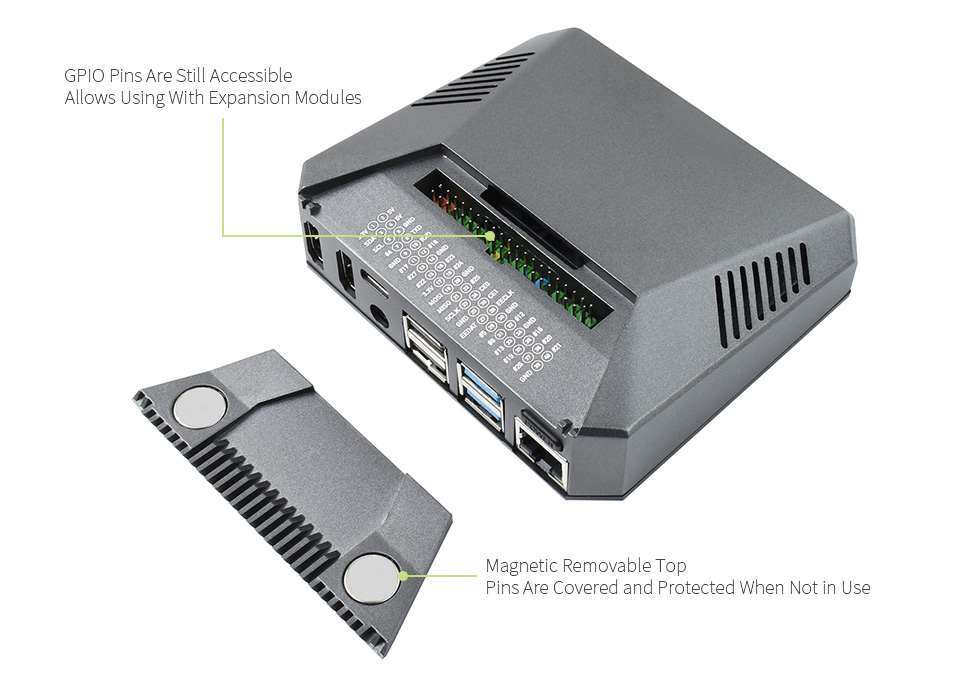

I am running Dietpi and i have the case argon ONE V2, with a gpio ribbon cable (the inkyphat can’t go in without it)
I have tried reconnecting the board several times, made sure it was pushed all the way in, i tried reconnecting the cable on the back of the inkyphat and checked for shipping damage.
