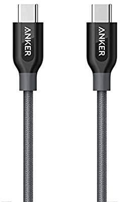

What power supply are you using? Mine didn’t work with a MacBook USB-C adapter and cable. It had the same symptoms as yours with no lights after plugging it in.
At the end of that article it suggested the usb-c cable may be the issue, so I tried the Anker cable listed above with my 87W Apple Power Adapter, and it worked!!! The RPi4 successfully powers up with this combination of cable and PSU. :)
Thanks for the article and the other reply. It’s an interesting read.
If the article is correct, it looks like any cable that is capable of more than 5V - 3A will have the chip in it and therefore won’t work.

From what I’m seeing on the Pi foundation forum, the issue is as described in that article linked to above. The one resistor wired to two pins instead of two resistors one on each pin. So its not Apples fault as I had insinuated.
