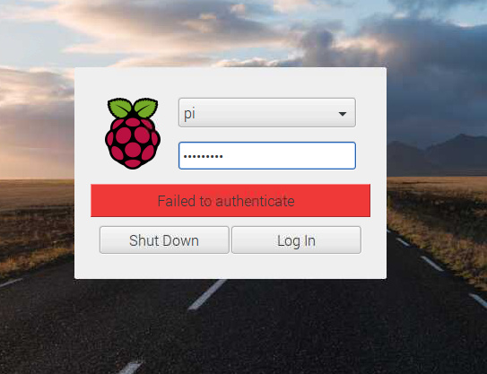

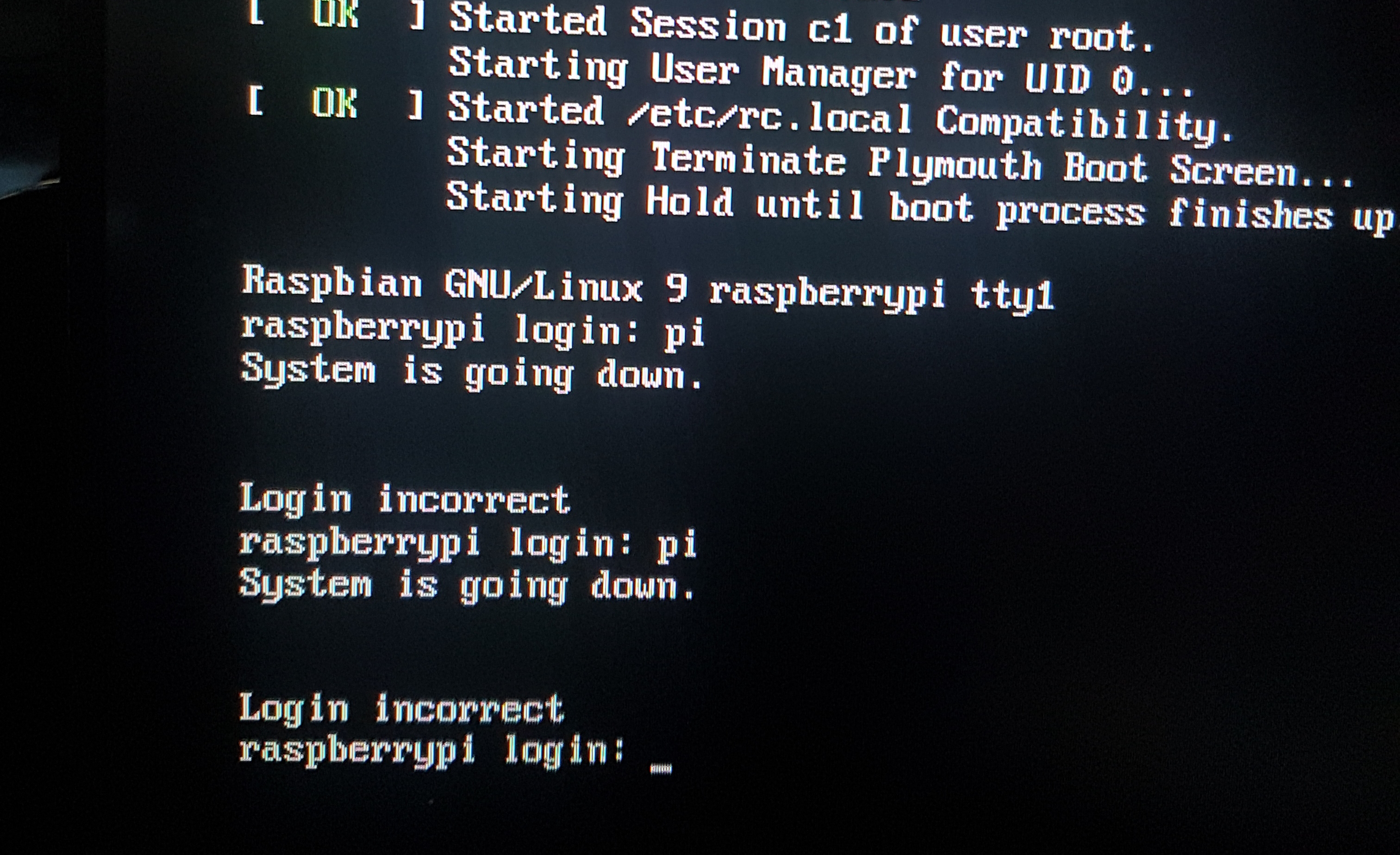

Installing the clean shutdown software using curl https://get.pimoroni.com/zerolipo | bash causes a “Failed to authenticate” error on the Pi when booting/rebooting. Entering the correct password does not work.
The only way to recover this situation is to re-flash Raspbian onto the SD card. I am using the July 2017 version of Raspbian and a Pi Zero v1.3.
Very annoyed - I have lost all of my previous installed configurations for I2S MEMS microphone, OLED display etc…

In the future, if this happens - not with our scripts, I mean generally, try to check that your keyboard is working and set to the correct layout, by booting to level 1 (Single-user mode). It could well have been the problem.

Before making my original post, I checked to see if I could replicate the problem. I tried twice with a newly installed version of Raspbian that successfully booted to the desktop. Both times, I got the “Failed to authenticate” dialogue window after installing the script.
I put this down to more than coincidence, hence I made my post.
I have never seen this dialogue window when booting the the Raspbian desktop before. The dialogue window appears before any keyboard input is made, and it shouldn’t be there in the first place. I would be very surprised if this was a keyboard problem.

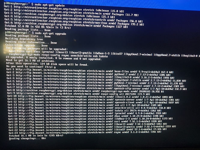

OK, so tried the other card, formatted and fresh latest raspbian lite img, ran update, upgrade then zerolipo and same thing happened.
#17
D’oh. Can you run the update/upgrade on a fresh install, but don’t install Zero LiPo? I’m trying to identify if it’s something unique to our script that’s causing the issue, or just general thrashing of the SD card from installers.
#18
Hi, i did that first and it all went through without any errors. I’ve done it again as had to flash card anyway. Card formatted was overwrite format rather than quick format. Only other thing done was to connect to wifi through raspi-config.
Update and upgrade went through fine. Did not run zerolipo or cleanshutdown afterwards. No problem logging in after reboot.

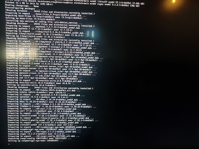

Thanks. Sorry, I had to go out but will do that this evening. I’m a complete beginner so you might have to use baby talk. So I just run the one liner…
git clone https://github.com/pimoroni/cleanshutdown
… and then just reboot with sudo reboot. I’ll photo the running script again in case you want to see it.
