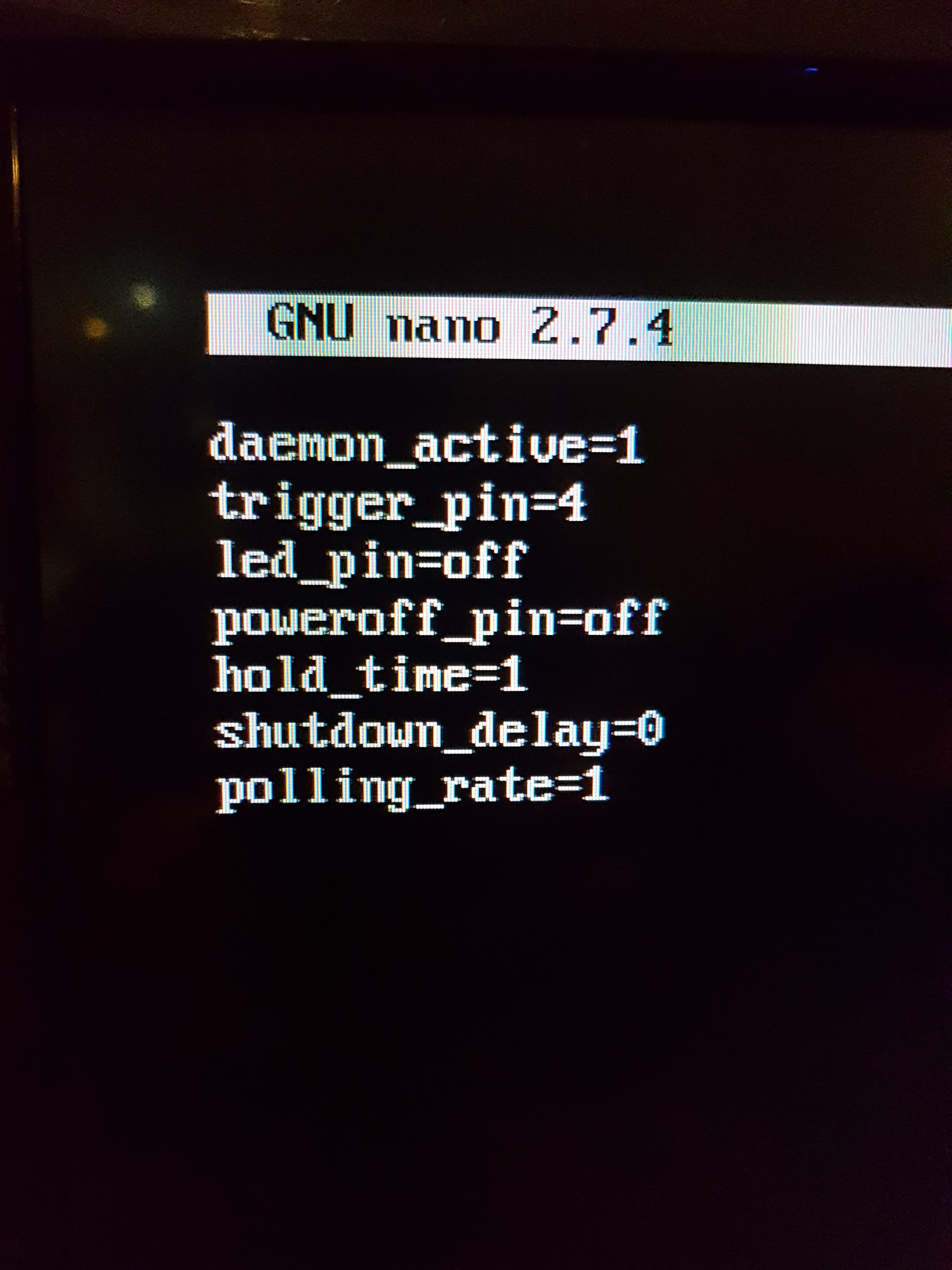

So I did that, rebooted and ran ‘git clone… clean-shutdown’ and got the following

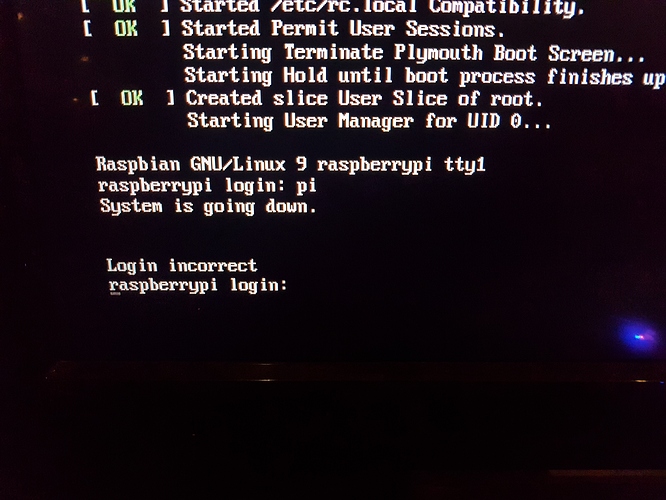

I think it actually shut itself down there when I went to just try insert ‘pi’ again although I may have mashed the keys a bit. Tried again on starting up and no joy
Oooh yes now it’s shutting down because the Zero LiPo thinks it has a low battery- behaving as intended, for better or worse. It should be possible to prevent that but I need to not be looking it up via a phone!
