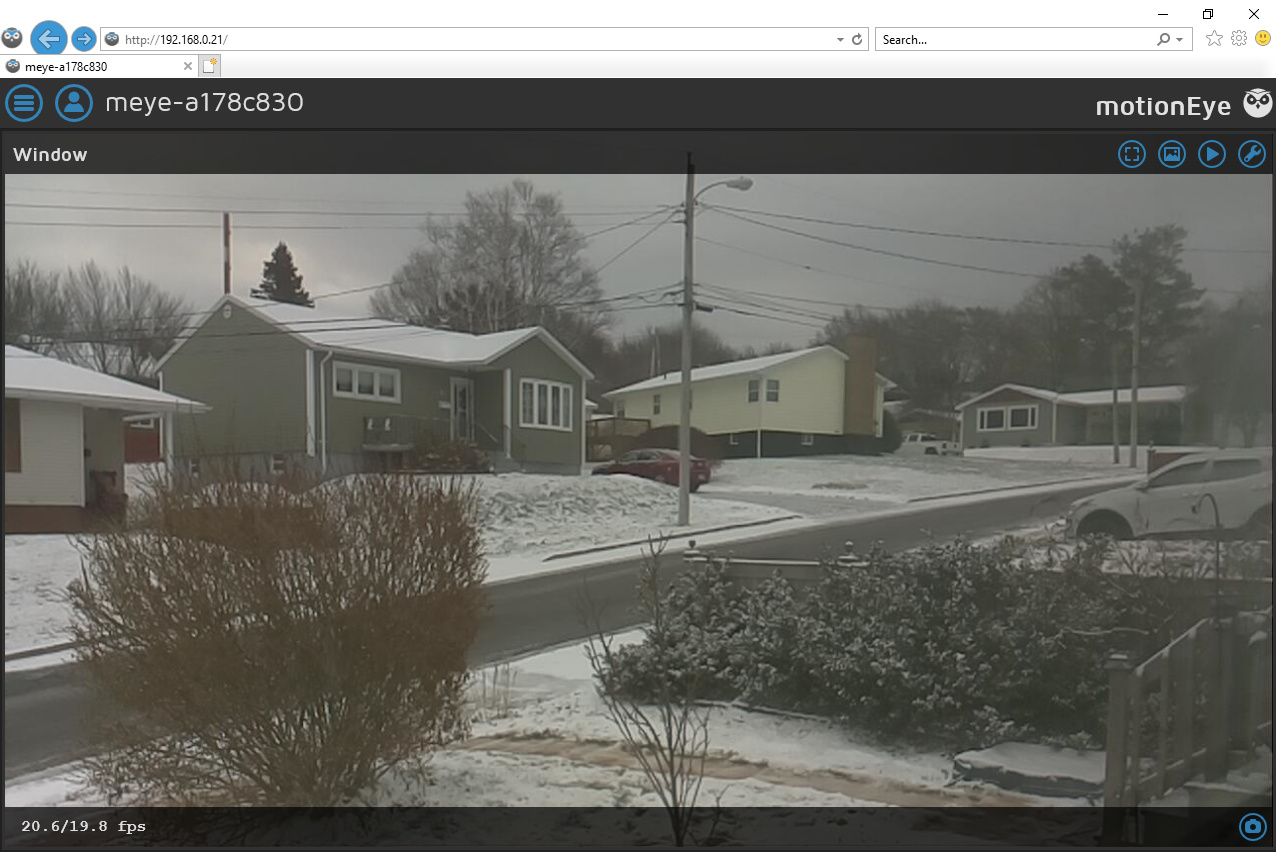

I went with Motion Eye mainly because I can view everything locally. I can do everything over my LAN. No having to stream to a web site on the Internet first. And go to that site to see my Video feeds or pictures.

Aah, so you just look at the picture on a monitor webpage with the ip address of motioneye.
In my case it’s 192.168.0.27 on a web browser page, and then if I want to view the camera picture from anywhere else, I add 8081 onto the end of the ip address.
For me, if I enter the ip address of one of my cameras I get the motion eye web interface.

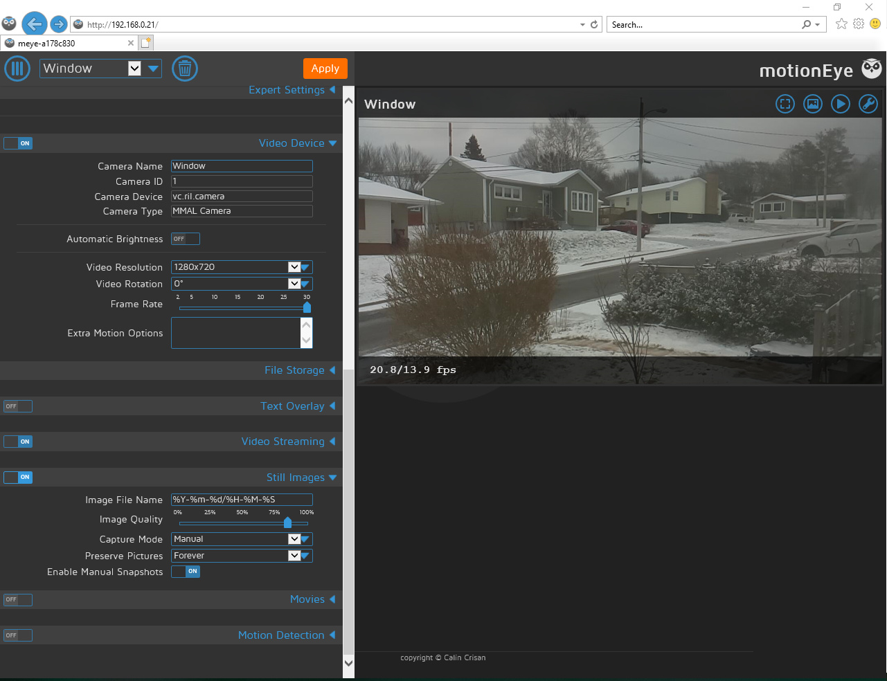

Then I log in as admin, and enable advanced settings.
Then turn on Still Images and Enable Manual Snapshots. Then an icon / button appears in the lower right hand corner. Clicking that takes a snapshot / picture.
I have mine setup a little different like you have, in as much that I have Capture Mode to Motion Triggered, and Preserve Pictures to For One Week.

Move the Layout Columns in Preferences back to 1 and your view window will be bigger when in settings.
I went with 720P instead of 1080P, 1280 x 720 will give you more FPS in videos and smoother videos, IMHO.
I also set my Movie Quality at 75% to get a better less laggy / shuddery video.
If your only taking stills disregard the movie quality setting.

Thanks, that improves the size of the picture, I can see it now, lol.
Yes I also have 1280x720 resolution, and it does help. Movie quality is set at 75% is the default, and haven’t changed it here.
