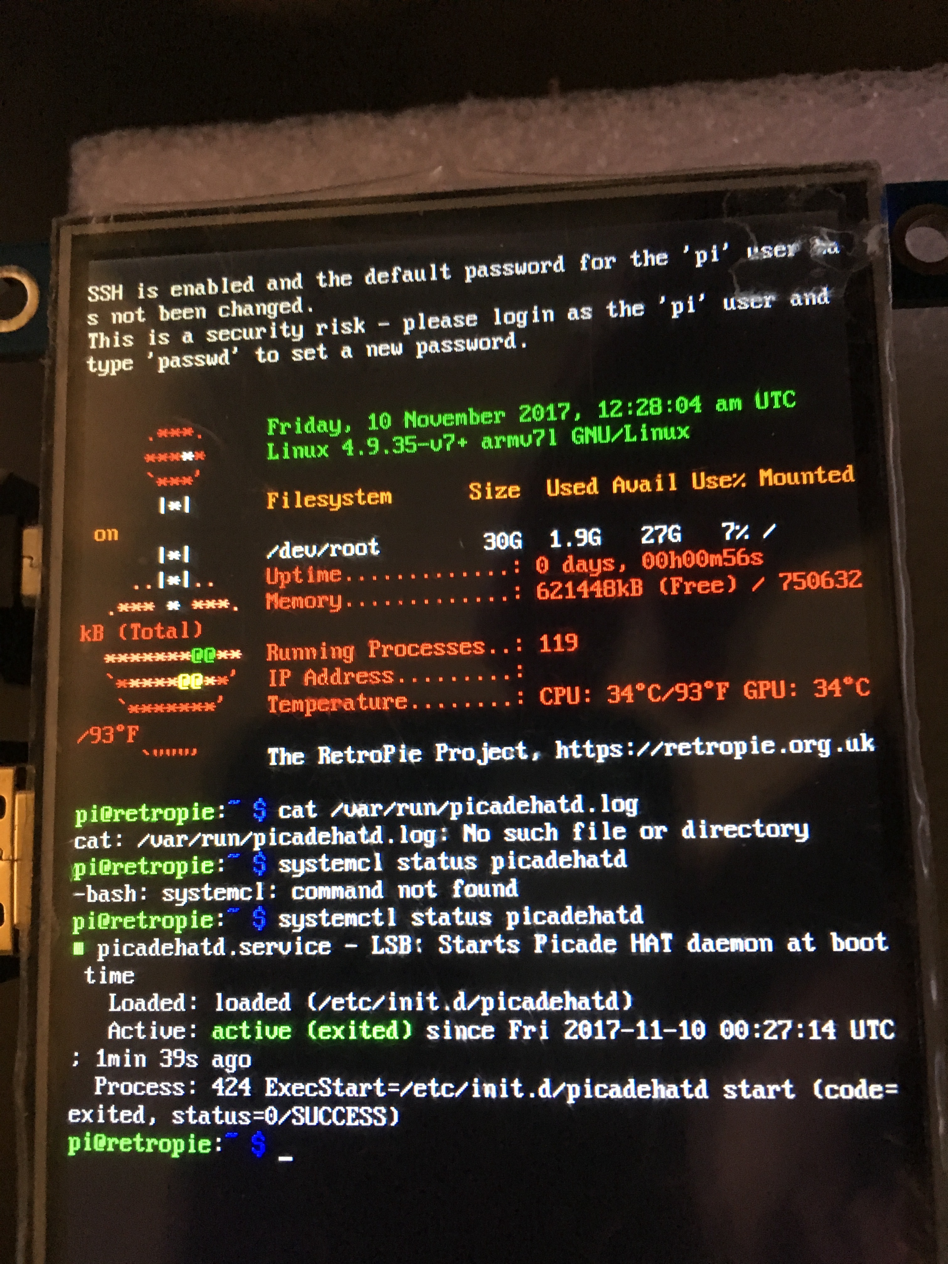

That means the input script isn’t running, or something’s gone awry with it.
Try running: cat /var/run/picadehatd.log
Or running systemctl status picadehatd
The first command didn’t seem to work. The second did. Looks like it’s running but still no luck on being recognized.
This could mean the picadehatd script isn’t running.
Would be worth checking for it with ps aux | grep python
And seeing if /var/run/picadehatd.pid exists.
If it’s crashing on launch we might be able to find out why and get some debug output by running it directly:
picadehatd
The file does exist. Running the program does not seem to do anything. Is there a way to generate a log when I run it?

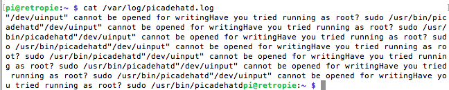

I was able to run the cat /var/log/picadehatd.log
here are the results.
I did this through SSH connection without exiting from ES first (as I had previously done)

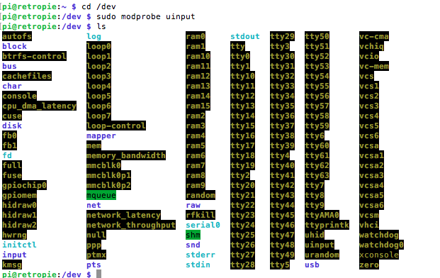

What happens if you: sudo modprobe uinput?
Does /dev/uinput exist?
Worth checking the contents of /dev after running sudo modprobe uinput, and also any recent output from dmesg which will tell you if uinput has failed for some reason.
It shouldn’t matter if you’ve already configured EmulationStation, although it will make it tricky to reconfigure to match the Picade HAT key bindings.
At this point I’d probably have reflashed to the latest version of RetroPie and started from scratch- but there doesn’t seem to be much wrong with your setup apart from a missing /dev/uinput which is one of the first things the picadehatd tries to set up: https://github.com/pimoroni/picade-hat/blob/master/daemon/usr/bin/picadehatd#L28
Are you saying there should be more than one uinput is /dev? There is one.
Also, would this explain why the SOFT POWER down still is non-functional?
